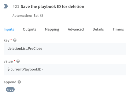

You can use the key ${currentPlaybookID} in the sub-playbook to grab the id of the playbook task. You can send this back to the parent playbooks as an output if you need to re-use it later. Refer to the screenshot below.
