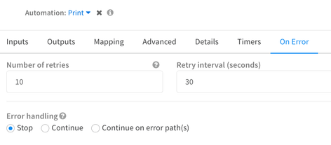

Hi @Josep, might need more information. Does ScheduleCommand command need to be re-tried of the command that it calls.
With the playbook task using the command that ScheduleCommand runs, in the below case I'm using Print. (Recommended method)
If you insist on using the ScheduleCommand, then you will have to create a wrapper script. The scheduleEntry command calls itself. (This method is not recommended unless playbook approach won't work)

Thanks for the reply,
"On Error" option does not appear in our XSOAR tasks.
You're right more info is needed, I refer to the command that calls inside "ScheduleCommand"
Hi @Josep, in older versions of Cortex the option is available under the advanced tab. Screenshot below.
