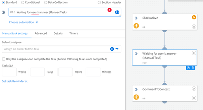

Please ignore my follow-up question above. I've found the solution to that using the argument Task in SlackAskV2 which will complete the next task that I crafted to be kept open until a response from the user is received.

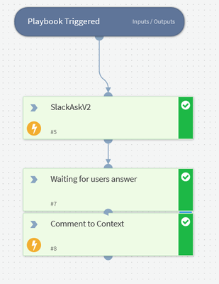

@ialonso make sure you put a Manual task directly after SlackAskV2, before commentsToContext. That is what pauses the playbook execution until the Slack response is received by XSOAR.
Plus one on @asawyer answer. It should be something like the attached image below.

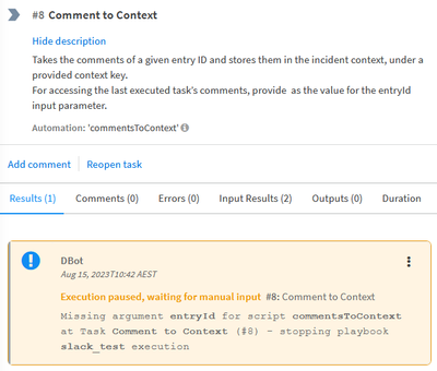

Hello all, I can't seem to get this working either. I have followed the process but no luck.Also it appears this integration does not return anything to context, so here we are trying for a work-around which appears to have worked for some people. I have attached some screenshots below. The last task, whilst closed, is still error-ing as per screenshot.
OK update to this, If I answer YES or NO in the manual task it works but just how do I know (without looking at the WarRoom what the answer was??)
