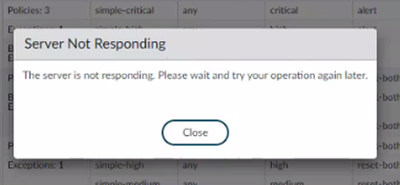

Hello all
Model: PA-3220
Firmware version: 10.1.16
  • I am not able to open some custom-created Anti-Spyware profiles after moving to 10.1.15-h2 from 10.0.X  then upgraded to 10.1.16 (being a preferred version ). showing the below error.
  • - default & Strict are there by predefined and are opening perfecty without any issue.
  • Created a test policy I am able to open that also.
  • Every service had been restarted as the firewall was upgraded.
  • Firewall in HA and the passive one shows the same error while checking the same spyware profiles.
  • Tried to clone the affected policy and faced the same error.
  • Checked the resource usage by show system resources follow and checked that there is no significant spike in the any parameter , more precisely %wa
Do we have any known Bug related to the same?

Resolved the issue by fixing the connectivity to  https://data.threatvault.paloaltonetworks.com:443/search_by_id  by allowing the same in security policy.
The issue was due to curl error: 35 when i clicked on the spyware profile, the firewall was trying to fetch the threat signature in background which was present in botnet exceptions, but due to connection error , it was getting timeout after particular period of time, there was a service route present for paloalto network services therefore i added *.paloaltonetworks.com in the security olicy and allowed it. and it worked fine.

I am able to figure out that this is due to threat-Id fetch from threat vault, that is not happening.
From show_log_system.txt
2022/06/21 12:01:16 medium general general 0 Could not access threat vault
Later fixed the connectivity because of service route being used
Then from wf_curl.log
2.786 +0300 debug: main(pan_wf_curl.c:931): Device Cert Status node not found, not using device certificate for mTLS with AF2022-06-21 10:51:52.786 +0300 Max timeout: 4
2022-06-21 10:51:52.786 +0300 debug: curl_set_opts(pan_wf_curl.c:280): use_sdb = 0
2022-06-21 10:51:52.805 +0300 debug: main(pan_wf_curl.c:697): full addr: https://data.threatvault.paloaltonetworks.com:443/search_by_id

2022-06-21 10:51:53.319 +0300 Error: main(pan_wf_curl.c:957): curl error: 35
