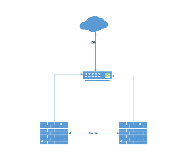

I have a simple query . I want to use PA firewall in HA and with a single ISP . In this case , as obvious, I need to use a switch in between my firewall and ISP and my understanding is clear upto this point but the real problem starts when I have to use two switches in between firewall and ISP for redundancy.
'My query is how can I achieve this ???? Do I to place 2 switches in stack and configure aggregate interfaces ?? or do I have another option of achieving the same ??
Pls help
Since your drawing only has one ISP, If the switch that the ISP plugs into fails, you wont have connectivity (unless you manually move cables around). If you add another ISP into the drawing, then that ISP will remain up and PA1 (the active one i'm guessing) would be able to get out via ISP2 plugged into switch 2. Now this works for outbound traffic. If you are hosting something internally, its a different story.

Hey thanks for converting my words into a diagram....
But see lets suppose I am using single switch , so here the problem is that my whole network is relying on this single switch..
I actually want to use 2 switches so that if one fails , network is still up.....Please guide me on that..

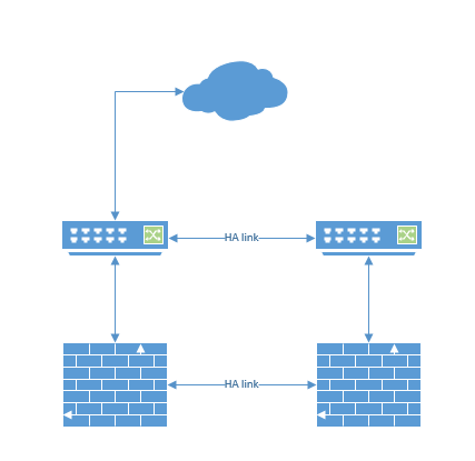

Hey no worries. So with two switches, you still have a single point of failure, e.g. the ISP. Here is a simple way of setting it up with two switches.
While you could get more complicated, I prefer the K.I.S.S model and with 1 ISP I dont see the need for additional complexity.
Since you only have one drop from the ISP, it can only go into 1 switch so if the switch that the ISP plugs into reboots or fails, the second switch doesnt provide any additional resiliency. Hence no real reason to have it, just my opinion.

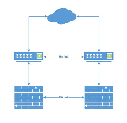

It would look something like this:
Then you have several options when it comes to routing. The simplest would be use 1 ISP as primary and then the second as backup. But there are other options.
yes obviously i need to add 2nd ISP .
But this approach is correct right ? I mean,  one wire from 1st ISP will be plugged into a switch and one wire from 2nd ISP would be plugged into same switch ..right ? ...I am referring these two switches as single switch because they are in stack....
Yes, for outbound internet traffic. Obviously plug each ISP into a different switch.
