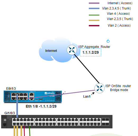

I m setting up a small office network where the endpoints are connecting to a switch that is in turn trunked to a PA220 Firewall . The firewall external interface is configured with a static IP address within the same range as the ISP IP router .
However it appears that neither the ISP router or the Palo can receive arp entries off each other let alone ping each other

Yes the connectivity is provided through an access port  . As per the attached topology the firewall connect to an Onsite router that only function in bridge mode with so  layer 3 communication is between the firewall and the aggregate router .
The ISP engineer  that  visited the site confirmed the Internet was working by plugging a portable device into the Onsite router ( LAN 1) and could get to the ISP Aggregate  Router using IP addresses within the same range .
Let me know if you have any further suggestions 2023-01-17 17_43_57-WAN - diagrams.net.png

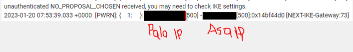

As per the topology I can t get the tunnel to the ASA working although the IKE parameters seem to match . The outside interface of the Palo can ping the ASA though . From an  ASA perspective I can t see nothing on the logs  .
This s the message I get from the NGFW .
Any help will be greatly appreciated
Crypto settings don't match.
Do you manage ASA side as well to check config?
"show vpn-sessiondb detailed l2l" is helpful to use on ASA side.
If you can't get this info then next step is to turn Palo side to passive mode and figure out what ASA is negotiating with using packet capture.
