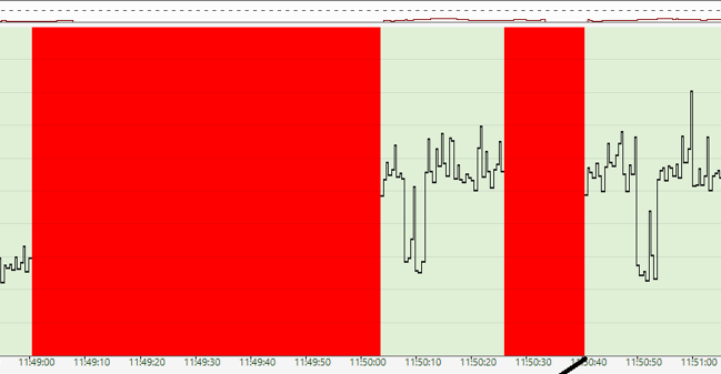

I created an HA group from device PA410 (the same problem on PA3250) mode active-standby , when i switch active device to passive, the passive device becomes active and i have a problem. there is no access to the firewall for about a minute
the following occurs for Pan OS 10.1.8

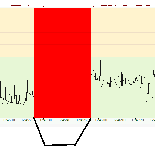

I did update pan os to version 10.1.9 h3
I see a slight improvement but still the unavailability time

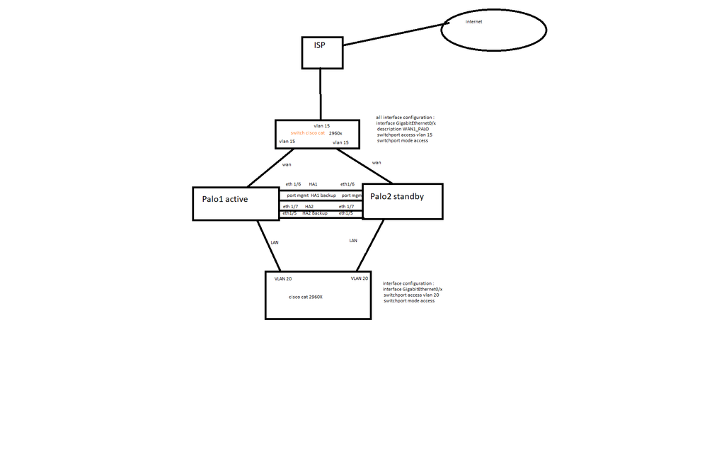

Bellow my branch diagram, The connection between Palo and the switch is one access link
configuration ha Pasive link state :auto
When I change to make activ devices standby and standby activ device i lost conection from lan to internet.

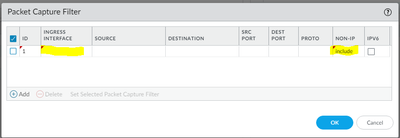

As next step I suggest to configure packet capture on passive firewall by configuring interface that connects to Cisco switch and include non-ip traffic.
Check how long it takes for traffic to start flowing in after firewall becomes active.

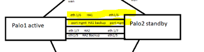

Just a random suggestion that is not related to your issue.
HA1 is related to mgmt plane.
HA2 is related to dataplane.
I would flip those ports around.
HA1 is used to replicate config and send heart beats.
Dedicated mgmt port is connected to mgmt plane but eth1/6 is connected to dataplane so this is not optimal setup.
