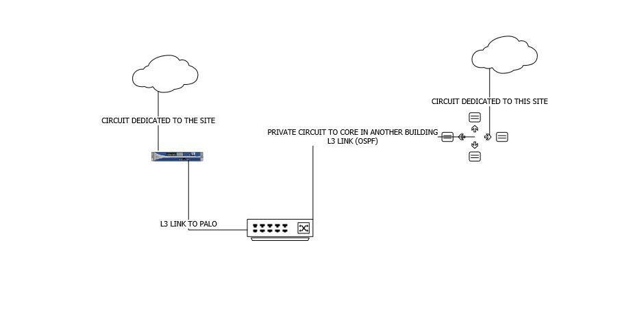

Quick design question Community. The setup is a core switch that terminates a Palo Alto for WAN and then a private circuit for internal resources back to a core in a different location. In the event they lose the WAN circuit, I need to route all the internet bound traffic back through the private circuit. I was going to treat it like a Dual ISP setup, where the private circuit is my backup internet circuit. Looking to see if there is a better way to do it, or if this is it.

I would have to see a diagram of your setup but it seems like a plausible solution.  You could:
  • Use a static route next-hop monitoring (if your are not doing dynamic routing)
  • Use policy based routing with next-hop monitoring
  • Select the next hop as decided by a dynamic routing protocol (OSPF, BGP, etc)
The biggest thing to be concerned with would be asymetrical routing at the other end, but if the circuit is hard down, that should be less of an issue.
- Matt
Thank you for the reply. I just realized the topic subject is not correct, my bad on a copy paste!
We are running OSPF Internally for the internal circuit, I could introduce the Palo into it if it makes sense. This is a quick visio of the design. This is a satellite office, all internal traffic goes back to their central office

I agree with @mlinsemier design. I have also used it very effectivly. We have since changed our model a bit and use OSPF and use the weighted metrics to determine which path the traffic takes.
