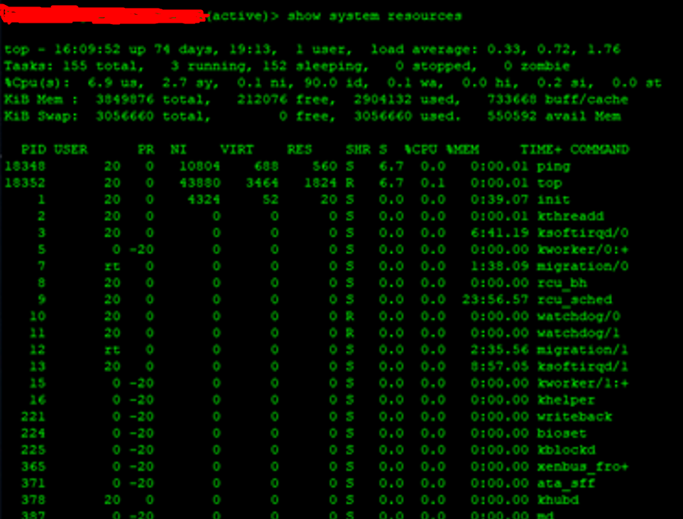

This is a recurring issue, a reboot helps for time being.
When attempting to update to the latest antivirus version, we see that the commit fails.
System resources look normal.
And looking at the techsupport file in /var/log/messages, we see that during various attempts:
mgmtsrvr, devsrvr, logrcvr were the killed processes due to out of memory and we see a stack of call traces (crash stack) after every out-of-memory condition.
Attaching the output of messages:

Looking in auto assistant tool - it points at Memory leak issue.
We tried to restart all three processes and tried to install the AV update but it failed again.
We monitored the resource utilization again and saw that httpd process was consuming around 130% of CPU and fluctuating up and down on a regular basis. Upon restarting the web-server process, httpd consumption went down and we were able to commit the changes and AV install was successful.
We similarly did the same on the secondary device and httpd CPU consumption went down.

show  system resourcesshow system resources
