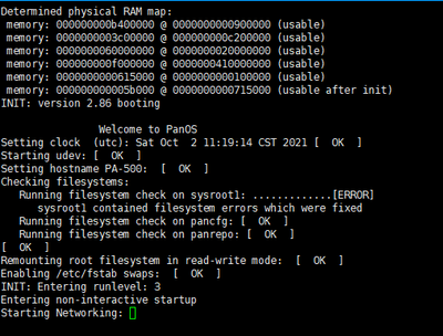

The firwall PA500 had a poweroff and boot,and after reboot the PA500 get a error with "Error: sysd_construct_sync_importer(sysd_sync.c:328): sysd_sync_register() failed: (146) Unknown error code
Error: unable to connect to Sysd"
When the device boot finished,the NIC port on dataplane did not power up and did not work.
We could connect PA500 using console or mgmt interface.

Also, we had find a error with task in web ui that auto commit failed:
  • Error:Threat database handler failed
  • (Module:device)
  • Commit failed
  • Failed to commit policy to device
I want to know, what  the problem happend for this device and how could I do for this problem?
