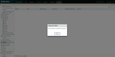

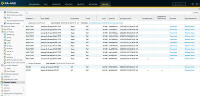

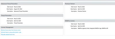

I have a bunch of PA440s and some of them cannot be upgraded as I keep getting an "An active license is required for this feature" message when clicking on Check Now under Device > Software. Device is correctly licensed and activated on the support portal, NTP is activated and sync'd. Dynamic Updates can be retrieved from the Cloud but PAN-OS cannot.
(I have already tried clicking on "Retrieve license keys from license server " with no success)
Current PAN-OS version: 10.1.3
Device Certificate Status: Valid
Anyone having the same problem?

Fix for our situation with the new Software NGFW credits and Deployment profiles and active license message (once Palo fixed restoring serials in backend - with matching UUID and CPUID and we attached again to another deployment profile that was active) was to run the software check from the CLI not from the GUI.
This fixed up the state that Panorama was in despite license showing as ok after license update and GUI throwing the non active license message in the software tab.
Hope this helps someone.....try CLI update first post license checks and then GUI post this if the CLI looks ok.
I had the same issue and ran "request system software check" from the cli and fixed the error message.
