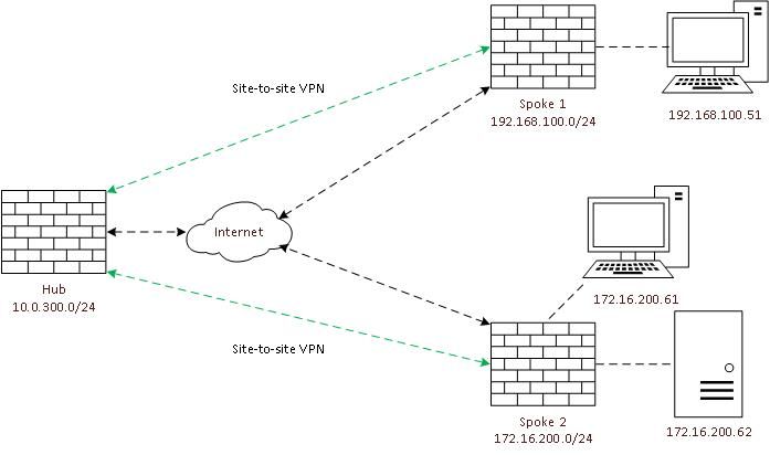

I have a working Hub & Spoke VPN network. Computers in Spoke1 can reach the computers in Spoke2 and vice versa.
For some reason, a particular device in Spoke2 with IP 172.16.200.62 can only be reached by the computers in the same subnet.
I want to know is it possible to assign a 172.16.200.x IP address to the computers in Spoke1 when they attempt to connect to that special device. I'm not sure this will achieve my target or not, but at least I can learn a new NAT technique if such configuration does exist.
The 3 firewalls below are PA-820.
Simple fix for this is by creating a NAT rule
Nat from Spoke1 to Spoke2 -
Source Zone - Tunnel Interface Spoke1
Source IP Address - 192.168.100.0/24
Destination Zone  - Tunnel Interface Spoke2
Destination Address - 172.16.200.0/24
Source Translation - Dynamic IP and Port
Translated IP - 172.16.200.100
I hope this will help
Hello @jeremylo
Why don't you apply a source NAT on Spoke 2 (hiding all requests to 172.16.200.62 behind the firewall interface 172.16.200.x)?
Bingo! It works!
Thanks Pawel.
Hello Joerg,
This is a solution too. However, I also want to keep track of which computer in Spoke1 have connected to Spoke2.
