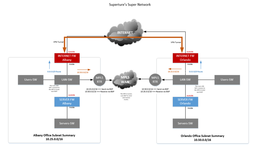

You would normally have a dynamic routing protocol setup to allow traffic from one site to another via your MPLS network.  Then you can easily use your default route to send traffic to the Internet firewall for your backup VPN tunnel.
This is an example of how a network would likely be setup to serve the function you describe.  When the MPLS goes down, you lose the dynamic routes and the VPN kicks in.
Haha looks great!

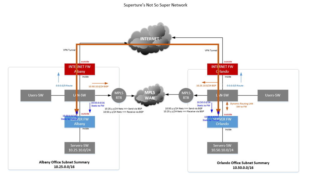

Your routing becomes problematic in the design you are attempting with little benefit.  In both scenarios you have your data passing over the Internet inside of an IPSec tunnel.  In either method you will need to implement a dynamic routing protocol to have an automated method for path selection.
Also keep in mind that when you have the VPN tunnel on the Internal FW, you will need to setup dynamic routing from your core LAN switch to the FW.  Otherwise the Firewall will always pass traffic between servers over the VPN tunnel and it won't use the MPLS.
Supertures Super Network 2.pngIn this example we summarize each site with /16 subnet routes.  These are static routes on the LAN-SW and the Servers-FW.  This will allow traffic to cross the VPN if we lose the Dynamic MPLS routing.
The LAN-SW's at each site will learn a more specific /24 route for the remote office networks and this will be a more prefferred path.  Traffic will normally use the MPLS network from site-to-site.
When your MPLS dynamic routing stops (due to circuit or router failure) these specific routes disapear and the next best path are the /16 static routes.
Also remember that all of your FW rules will need to be built with the new VPN tunnel zone as a source or destination on the Server-FW's at each location.
