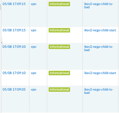

Hello just for everybody's information... Actually vpn tunnel was being established and closed every two seconds or so. I could check this in the logs. On the monitoring part of the firewall everything seemed normal (Network => IPsec tunnels) but the TS associations were going up and down and traffic was being impacted of course. To check the logs go to Monitor => System and go for this kind of messages (I've filtered using the SPI id on the description). Look for TS association errors => This means proxy ID aren't matching between your Palo Alto firewall and the FW on the other end. You need exact matches. We replaced ASA w/ Palo Alto and the same configuration for crypto maps was not working. Hope this helps someone on the future :).

Hello, I've found an error... ipsec SA keeps being established and going down every second or two seconds. I don't know why but I least it's a clue
This points to mismatching proxy-ids.
Check that encryption domain / proxy-id is exactly the same on both side.
If you switch temporarily to IKEv1 then you can see in system log what proxy-id's Fortigate sends to Palo.
Otherwise you need to troubleshoot in cli to get this info.
