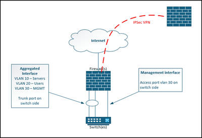

You can't route traffic directly from dataplane to management plane. There has to be switch in between.
Below is example using random vlans and IPs.
And then firewall policy can be added to permit traffic from VPN zone to management zone towards Palo mgmt IPs.

As far as I know, dedicated out of band management interface isn't part of any security zone.
Based on the above example, if the dedicated MGT port to be accessed via IPSEC VPN, can you pls let me know how the routing should be setup?
Again, to the best of my knowledge, MGMT interface doesn't use the VR as this is for data-interface.
Please correct me if I miss anything 😊
