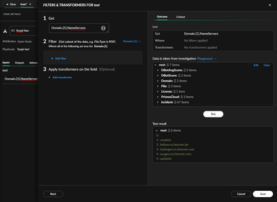

Hi again,
well, I guess it does not really matter, the "for each input" loop needs an itemizable list so that for each works,
easiest way to figure that out is to use the Transformer. So basically if you test with transformer we want a list coming out in the test field, if that is not the case you would need to add transformer to manipulate until you have the desired output
