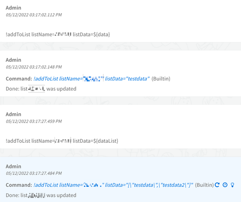

Hi @Josep, The setList automation is designed to overwrite the data inside the list. Could you try addToList automation? It should work like shown in the screenshot.
Good morning Fernandes and thanks for your answer.
The purpose using "SetList" is to overwritre the data. First, we download all json to context, we manipulate it, then "SetList" commmand updates using the context the json, overwriting. However, sometimes the value of the key-value pair can be an array, so this causes a malfunction.
Normally it will be: {"${key}": "${value}"}
But with an array should be: {"${key}": ${value_array}}, with  no "
So the point is how to use the same json value format for both cases.
Hi @Josep, the only option would be to merge\join the data before calling the setList command. You could try using the "Join" transformer. It will work with string and list inputs.
