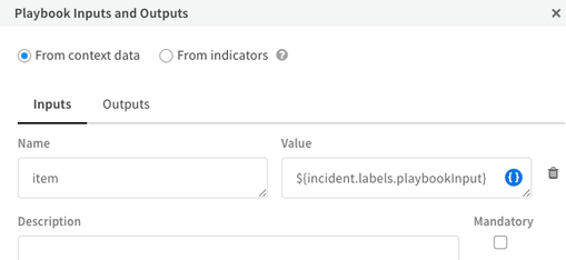

I would recommend this method. Configure the playbook like this.

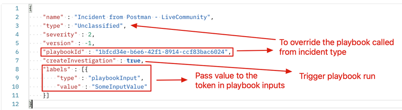

You can then send a postman request like this.
