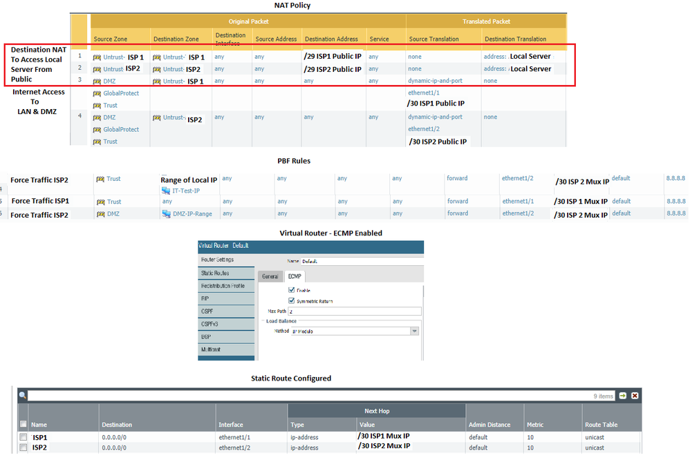

G1/1 - xxxxx/30 (ISP 1)
G1/2 - xxxxx/30 (ISP 2)
G1/3 - xxxxx/24 (LAN)
Both the ISP have also provided xxxxxx/29 range of usable IPs
Have Configured Dula ISP Redundancy with single virtual router by enabling ECMP and link monitor for static route
Have configured source NAT to access internet from local LAN  ( G1/1 & G1/2)
Have also configured PBF for specific zone/network to access internet from specific ISP ( G1/1 & G1/2)
Configured Destination NAT from public IP xxxxx/29 to local server (red). for both ISP it's configured
When both ISP are connected
able to access local server (red) from internet on only from ISP1
But when i disconnect ISP1 from firewall then am able to access local server from internet through ISP2
can any one plz help.

Can you share how you have configured the NATs in question. Your NAT policies are evaluated the same as the security policies, so the first NAT policy that matches the traffic is going to be the policy that gets used.
Best case scenario you are able to advertize one IP range across both ISPs, but unless you actually own the IP range then the ISP is unlikely to agree to this. There are other ways to accomplish what you are trying to do but the easiest way to configure this is actually to just have dual IPs on your server in question and setup completely seperate NAT policies for both IPs to allow access.

Is this configuration Correct

Does this config now work or did you create this after this topics discussion?
Looks actually pretty good, I think
