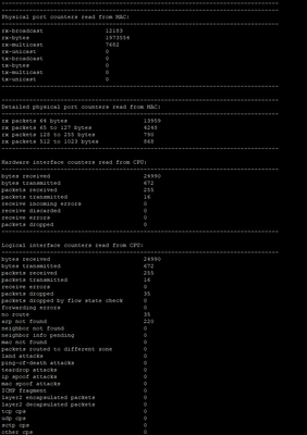

My issue don't let me sleep. My firewall (PA-3410 v11.0.0-h1) doesn't process traffic, I can't do ping at other interface than MGMT. The Monitor is clear!.

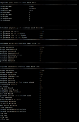

The only thing I have observed is that the traffic reaches the MAC interface, but the CPU counter does not increase.
After a few minutes sending ICMP and HTTPS traffic, it shows this:

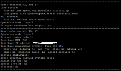

Do you have an interface management profile that would allow you to ping interfaces? By default, the firewall isn't going to have ICMP active on an interface address. Likewise the intrazone-default policy doesn't have logging enabled by default (nor does the interzone-default policy), so you may simply not be passing any traffic that would actually be logged. Without knowing how you've configured your security rulebase it's impossible to know if that's a real issue or not.
Yes I do.

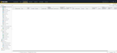

Inter-zone traffic doesn't show it. Logs at the policy are enable. It's not the first time it's happened to me, I still haven't solved the previous case.
