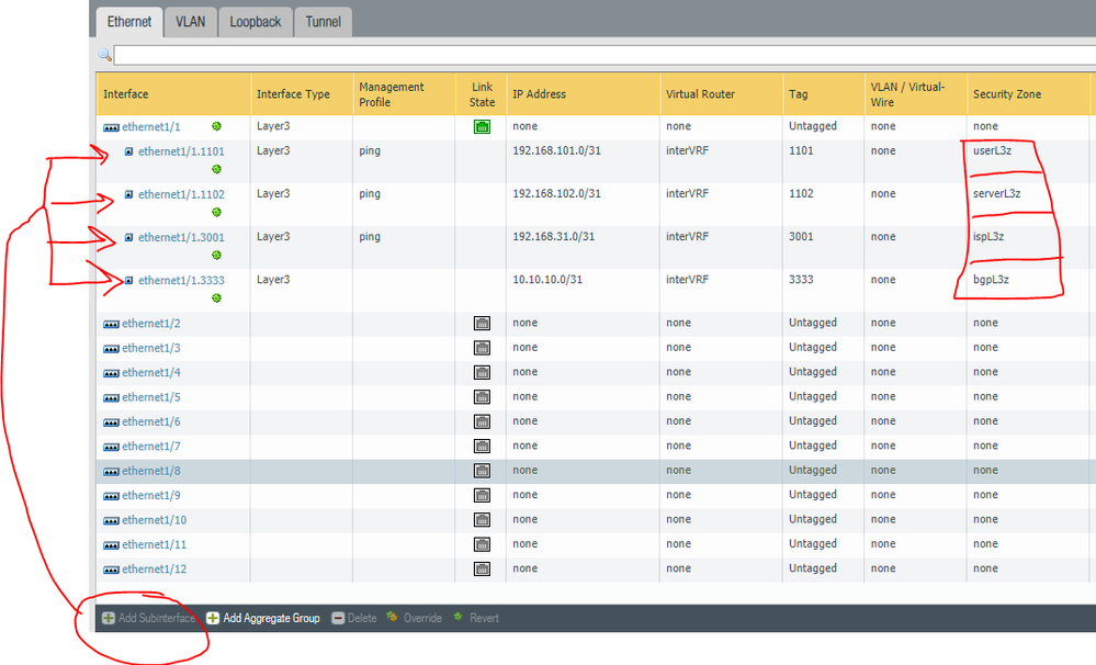

Why are you using separate ports for each service?  This seems to be an extreme waste of ports.  Why not just use a single port on the PAN and create subinterfaces for each service if you are going to separate them that way?
ISP <---> Router <---> PAN (subinterface 1,2,3,4)

I have used subinterfaces.
you add first IP to layer 3 port and in advanced, tick "untagged subinterface"
select the interface and at the bottom of the page you can add subinterface.
give it a unique number (I use the last octet of the address as a reference) and add it to it's own zone.
not everyones cup of tea but works for me...
How i  create subinterfaces and how i can linked to zones
add one ip address to interface 1/1 and go to advanced and tick the box for "untagged subinterface"
then select the interface again and the option to add a subinterface is at the bottom of the page

slightly different but same result as no tagging involved
i had to reduce in size as i could not draw the red pointy multi pronged thing...
