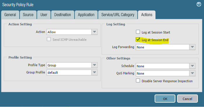

Please check if you have a log enabled fro the security policy:
Generally, should be enabled on the "session end".
Thanks,  I did check both secuirty policies and they are set to "Log at Session End".  Also,  I was thinking my routing could have been setup wrong.  I have the following:

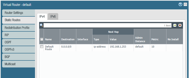

The setup instructions state to set up the route "pointing to the ISP's next hop".  This is where i'm getting confused, am i supposed to send it to my wireless router, to the cable modem, or the hop after the cable modem?

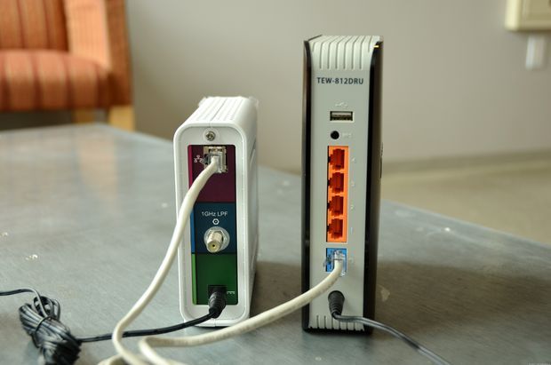

So if you are connected to the Internet "through" your wireless router (you got a cable going to the router) then static route should be pointing to the wireless router IP address. Your cable modem as l understood there just for signal converting, so you cannot manage it. Is it similar for this set-up:
Please could you confirm your wireless router IP address/network? Also email me here: [email protected] so I can send you few more helpful info.

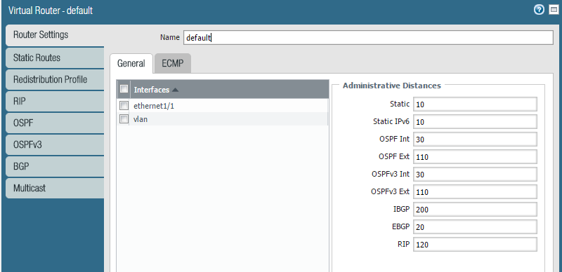

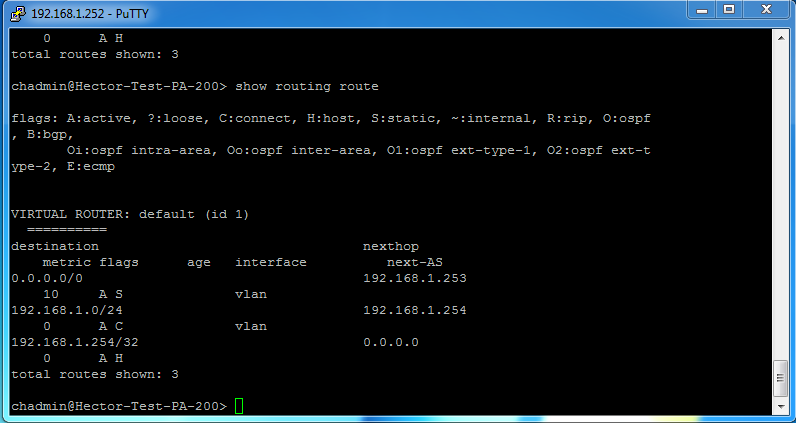

Your setup is rather odd and without looking over the total configuration I can't tell whats wrong, I can only take crack shots on the information you provide. I did notice that the current route for 192.168.1.0/24 is showing your next hop as 192.168.1.254, which I didn't see mentioned anywhere on your network setup. What does your interface configuration look like?
This might be a little faster to just dump the configuration, take out everything you don't want people to see, and upload the file. I feel like there may be multiple small configuration errors across the configuration that you are running into, that would take a while for the forum to pinpoint each individual issue with screenshots.
It might be worth throwing your wireless router out of the picture and setting up an "UnTrust" zone on your firewall along with a "Trust" zone, and setting your "UnTrust" interface as DHCP. Understanding that you will still need wireless put your Wireless Router behind the firewall and simply put it in AP mode. Running your firewall behind your wireless router isn't exactly the best setup anyways from a security perspective, as this would allow wireless users to completely bypass any security that you have setup on the firewall.
If your wireless router IP is 192.168.1.253 then you got you default route correct. Use Layer 3 mode for your interfaces configuration. Your PA interface has assigned ip 192.168.1.254/24. Put this interface to the "untrust" zone. Create another "trust"zone with different IP address range, assigned other interface to this zone, set up DHCP with. For DNS you can use your wifi router IP or Google dns. For the client in the "trust" zone DG is going to be your PA interface (trust zone IP). Configure NAT (PAT) pointing to your external PA IP address (192.168.1.254). Create security policy for traffic going from the "trust"> "untrust" zone. This will be enough for you get you familiar with Palo Alto, so you can test things but it is temporary set-up 🙂

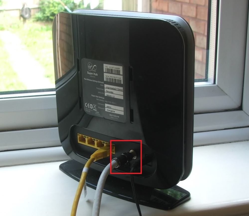

As l understand he cannot connect/attached  Palo  directly  to the mode, that is why he has to go through the wireless route.
Sure you are correct if you can connect Palo directly to the modem.
p.S I could do it because my modem/router is Virgin Media and has specific interface:
