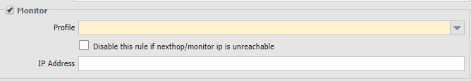

I also wanted to consult once the monitor profile was created to know if the tunnel is UP or DOWN, when I select "failover". How should the PBF rule be with another ISP? I am looking for the tunnel to be UP in case the principal no longer responds and performs failover.

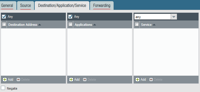

So the Negate translates to "not equal to'. Let ssay you have 192.168.0.0/16 on your internal network. Now lets say you want all traffic 'except' a certain subnet(s). This is where you would use negate so that the rule is 'cleaner'
example:
i dont want the policy to apply to the following subnets: 192.168.199.0/24 and 192.168.66.0/25.
If you were to apply a 'Permit' policy you would have to list out all the subnets except those you dont want. So instead you use the Negate.
What this does is allows all subnets 'Except' the ones listed.
Hope that makes sense.

The monitor sends pings to the IP specified to verify if it is up or down. Check out this article about dual ISP's and PBF failover.

[ ] Monitor
Profile: Failover_VPN_Tunnel
IP Address: 192.168.2.4 (any IP from a host at the other end)
[] Disable this rule if nexthop / monitor ip is unreachable - Selected

MONITOR
IP Adress: 192.168.2.4 (any IP from a host at the other end)

When I configure tunnel monitoring, in the part of:
MONITOR
IP Adress: 192.168.2.4 <--- This address should be the same as that configured in the tunnel interface? Network -> Intereface - Tunnel?
Regards!

Correct, the monitor IP will the the IP that the PAN will ping on the other side of the tunnel to verify that it is up.
Hi Otakar
So can it be any IP on the other side of the tunnel or should it be the IP that is assigned to the tunnel interface on the other side?.
regards
It can be any IP.
While it can be any IP. I always recommend you use one that is as close to the VPN endpoint as possible. So yes I would recommend the Tunnel IP.
reason:
Lets say I have the following:
switchA --PANA--VPN--PANB--switchB
If I use switchB's IP for the PANA monitoring, if that switch goes down/reboots the tunnel will fail over.
If I use PANB's IP for PANA monitoring, it will only fail over if the IP of PANB is not reachable.
Just my thoughts.

In the PBF
Policies - PBF
Here it is necessary to place
 the IP address again if I choose the profile?
In "Destination" within the PBF should I enter the network address? or the address of the Gateway?

I do not understand well the operation of "Negate"
Negate just means 'Not Equal To' so lets say you want everything to route except a specific /24 you would enter that /24 network and select negate.
The monitor is just a ping so it can be anything. The PBF is a route so it needs to be the IP of the next hop router.
