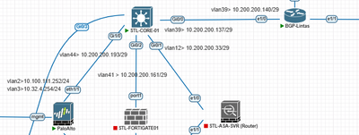

Good Afternoon guys, how i could reach network 10.100.111.0/24 inside Palo Alto from Router BGP? i have success to get routing table of 10.100.111.0/24 from Router BGP, but unfortunately i can't ping into gateway of 10.100.111.252/24. How to solve this? Thank you

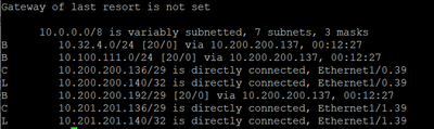

This is route inside Router BGP :

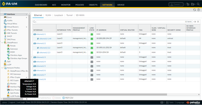

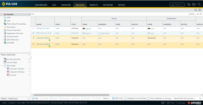

And this is the IP & Security inside PALOALTO :
Hello @Mikhailzd
Does management profile on Palo Alto's L3 interface allow ping? Here is a reference: How to Allow Ping and ICMP on Layer 3 Interface of Your Palo Alto Networks Device
Does Palo Alto has a route back to the switch?
