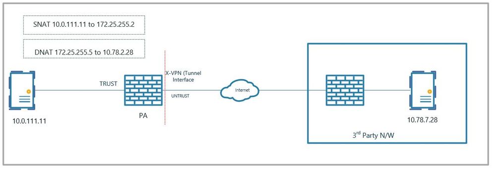

I'm trying to configure a site-to-site vpn with between two organizations.
Our internal IP range is conflicting with the other organization network, so we are trying implement Source and Destination NAT
The VPN tunnel is up, but I'm struggling to NAT Source and Destination.
Route : 172.25.255.0/29 via Tunnel.50

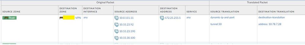

The NAT policy Configured as below.

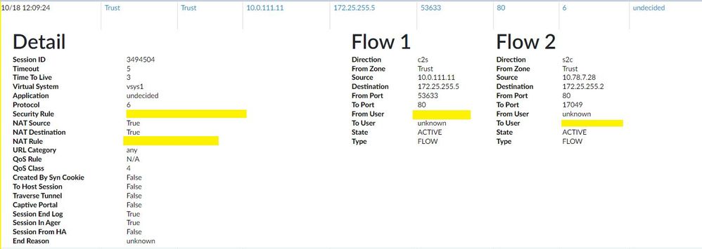

Session Flow

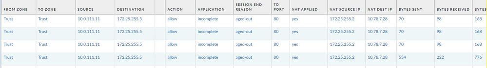

Traffic Logs

Your traffic is not sent into tunnel because post-nat IP matches to your local subnet and it is routed to trust zone.
You should set up NAT on both sides by applying SNAT and DNAT for the traffic on both sides.
