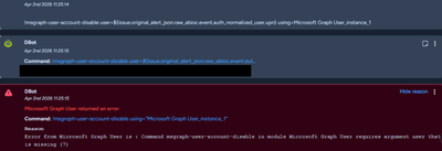

I want to create a playbook that uses the Microsoft Graph integration to disable and revoke a users sessions. I have a problem with the alerts not containing the UPN but instead creates its own naming convention that follows the format domain\user.
Looking at some of the built in playbooks that work with graph queries, the input field for UPN is Core.OriginalAlert.event.raw_log.properties.targetResources.userPrincipalName which I cannot get to work in my playbook. When running the command, !msgraph-user-account-disable, manually from the war room and selecting the input as the built in "UPN" it also looks like this defaults to ${issue.original_alert_json.raw_abioc.event.auth_normalized_user.upn} but it does not successfully pull any data and errors out. Please let me know if there is another way I can do this on my end or if its something Palo needs to look at
