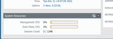

Hi We can check how much CPU that PA is using, but it does not show how much RAM the Palo alto is using. How can we show it at GUI? Thank  you

I am not aware of any way to check it directly from Firewall's GUI, however if you have Panorama in your environment, you can check it from:
Panorama > Managed Devices > Health > then navigate to Firewall and select: Resources > Memory
Directly from the Firewall, you can check it from CLI. Below KBs might be helpful:
https://knowledgebase.paloaltonetworks.com/KCSArticleDetail?id=kA10g000000POEKCA4&lang=en_US%E2%80%A...
https://knowledgebase.paloaltonetworks.com/KCSArticleDetail?id=kA10g000000PNtHCAW
The last option could be to use SNMP to pull that information from your monitoring system.
