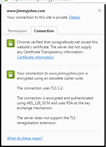

Just floating this out to the community. We have had decryption enabled for the past 2 years. In the last 6 months we are adding a new site to the no decrypt category about once a week. We are up to 94 sites that it can't decrypt. Yesterday it was Office365 exchange that stopped woeking, today was the kicker with microsoft updates failing even though we have always had update.microsoft.com in the list not to decrypt. Last week we added Jimmy John's wich we have been using for ever. Is this happening to others?

I don't think Jimmy John's is the RSA support issue, because we're cracking it and it's working for us.
You might want to review your decyption profile @craymond and make sure you've got support for unsupported ciphers.  Though there is a known issue that even though you've got the box checked it still doesn't work, and there for requires admins to bypass SSL Interception for that particular site.  (For reasons like @bmorris1 said, Palo's lack of support of certain ciphers on code versions less than 7.1.X)  Sites have been ramping up using stronger ciphers that until 7.1.X palo didn't support.

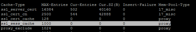

Also could it be possible that your hardware is running out of resources to support the increased use of SSL across the Internet?  Hardware purchased 3 years ago might be reaching it's limit since pretty much every site is SSL now.
If it is a resource issue then you can quickly check the pools
> debug dataplane pool statistics
You can also check the counters that match the proxy
> show counter global | match proxy
It would be worth clearing the exclude cache as well, but you'll see the usage in the pool output.
> debug dataplane reset ssl-decrypt exclude-cache
