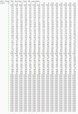

We are experiencing an issue that is becoming hard to isolate, our end users noticed network slowness about a few days ago.
During Isolation and investigation it led us to our NGFW PA-3260's.
This causing extremely High latency when reaching out from our Inside to Internet interfaces.
Resource utilization (%) during last 24 hours:
session (average):
9 7 4 3 3 3 3 3 3 3 3 3 3 4 5
5 7 10 11 11 11 11 11 11
session (maximum):
10 9 6 4 5 3 3 3 4 4 4 4 4 5 5
6 9 12 12 13 13 13 14 13
packet buffer (average):
5 1 0 0 0 0 0 0 0 0 0 0 0 0 0
0 0 3 10 17 17 16 24 34
packet buffer (maximum):
60 22 3 3 1 1 1 1 1 1 1 1 1 3 2
3 3 75 77 76 76 77 77 77
packet descriptor (average):
0 0 0 0 0 0 0 0 0 0 0 0 0 0 0
0 0 0 0 0 0 0 0 0
packet descriptor (maximum):
3 2 0 0 0 0 0 0 0 0 0 0 0 0 0
0 0 1 1 2 2 2 1 1
packet descriptor (on-chip) (average):
20 12 7 7 6 6 6 6 6 6 6 6 6 6 6
6 7 11 18 19 20 20 24 31
packet descriptor (on-chip) (maximum):
100 100 100 100 60 40 56 72 49 80 34 56 54 100 91
100 99 100 100 100 100 100 100 100
Is there a way to isolate this down better to mitigate what is causing the issue.
- We have turned off SSL/TLS Decryption
- Our Session Count is no where near MAX
- Out over bandwidth is 2Gbps, we see average of 400-500mbps with spikes up to 700mbps and more rare spikes to 1.25Gbps

show running resource-monitor ingress-backlogs
Fri Nov 21 10:35:00 2025
-- SLOT: s1, DP: dp0 --
USAGE - ATOMIC: 17.87109375% TOTAL: 94.140625%
TOP SESSIONS:
SESS-ID PCT GRP-ID COUNT Special Notes
651048 12% flow_fastpath 132
300786 2% flow_fastpath 23
SESSION DETAILS
SESS-ID PROTO SZONE SRC SPORT DST DPORT IGR-IF EGR-IF TYPE APP
300786 6 GP_VPN 10.185.72.224 62896 141.185.3.200 1433 tunnel.1 ethernet1/13.242 FLOW mssql-db-unencrypted
651048 6 inside 10.185.34.152 62682 199.232.214.172 80 ethernet1/13.242 ethernet1/24.1000 FLOW ms-update

Hi @HungTrinh ,
Have you seen this document -> https://knowledgebase.paloaltonetworks.com/KCSArticleDetail?id=kA10g000000ClRTCA0&lang=en_US.
Tom
Have you found the solution ? Because it's seems to be related to packet descriptors : you can try this command.show running resource-monitor ingress-backlogs
https://knowledgebase.paloaltonetworks.com/KCSArticleDetail?id=kA14u000000oNeOCAU
