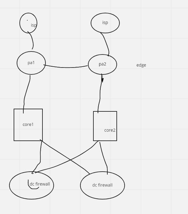

Hi all ,
I have the above topology , Now the question where should iI keep the dmz zone
on edge firewall or dc firewall
ideally on a separate switch environment connected to the edge
if that's not possible, on it's own VLAN on the core, connected via trunk on a subinterface on the edge
those would be my preferences 🙂
