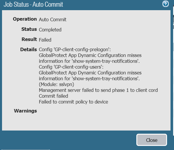

Device stays in Not Ready state for long time. Auto commit also failing. Could someone help please. Is there a CLI to resolve this issue. I found one, but couldn't recall it now.

Please post commit error why it is failing?

Hardware model - PA-3250. I'm getting this error on loading 9.0.0
If I try loading any other builds, I don't see this error. I tried 9.0.0 on another PA-3250 & it works fine

If you go into the GlobalProtect portal config and into the app settings and simply click OK in that configuration the firewall should correct the configuration error that you are running into. Looks like the configuration migration simply didn't update the config properly, and this will be the easiest way to fix that without having to issue a forced commit or modifying the XML file.
Thanks for the response. The same build works properly on another PA-3250 device,
