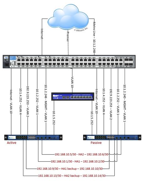

I will configure HA on an existing running production PA-3020 and then add a second as Passive.
  • There should be no network loss or downtime associated with the HA configuration procedure, correct?
  • I could configure HA, sync to Passive, etc. without configuring Link/Path monitoring until we are ready, correct?
  • I am wondering if there are methods to test for flaps on Links and Paths before configuring to determine appropriate timings and avoid unintentional failovers?
Thanks again for the support!

I am getting scared about the MAC address change.
Which interface MAC will change after enabling HA?
I will not be testing failover yet, just configuring HA.
After enabling HA (MAC address change), should I expect network switches connected to Active PA to update ARP automatically and connectivity if there is an interuption?  Or do I have to do something manually on the switches to clear ARP cache?

I was just talking to support about it.  He suggested that I could do a dataplane reset after enabling HA on the Primary firewall and that should do G-ARPs to have connected devices/switches update their ARP and MAC tables WITHOUT the need for clearing ARP and MAC tables.
I was thinking (to avoid an unintentional failover) I could configure HA on the primary with no HA cables plugged in, restart the dataplane to get the G-ARPs sent out and updated, verify connectivity, then plug in HA cables, enable HA on second device, and do a sync.
Of course understanding that there will be network interuption until dataplane is finished restarting...
Does that all sound right?
