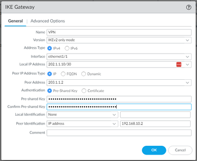

Palo side
If Cisco router don't have DNAT rule to forward packets arriving to 203.1.1.2 further towards 192.168.10.2 then it makes sense to make Palo to be passive.
"Enable NAT Traversal" will encapsulate IPSec packets into UDP packet. This is needed if NAT is involved.
check out @Raido_Rattameister reply. The natted firewall/vpn endpoint needs to have the IP listed as the "Peer Identification" IP address. So point your tunnel at the public IP and the Peer Identification as the VPN endpoint device.
