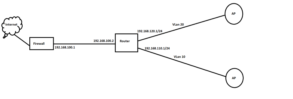

So we were using a router with two VLAN 10 and 20, connected to two different APs and everything was working fine.
Today we purchased a firewall and we placed it before the router (refer to the image). I created two static routes 192.168.110.0 with Gateway 192.168.100.2 and 192.168.120.0 with the same Gateway. Still, we are not able to access the internet.
Any idea what I am doing wrong? Any other way to configure this whole setup?
- Check if the related interfaces are up and green on both side. Right Cable should connect to right interface 🙂
- Do you see related interface arp entry in both side Firewall and Router.
- Check İF config on Firewall are they belong to same virtual router.
-Check for defeault route in virtual router there should be 0.0.0.0/0 to isp router faced interface and ip.
-Try to ping internet from firewall, isp interface.
-Try to ping internet from firewall  mng. interface.
-Try to ping router from firewall 192.168.100.1 if to router 192.168.100.2 if.
-Check İnterface Config on Firewall ip adress is not a shadow object, create an address object than assing it.
-Check interface profile and allow ping. (You must write a rule)
-Check interface and Zone seetings related interface is assign to related Zone
-Check security policy create one any to any rule enable log start and log end to see whats hitting to firewall
-Check NAT Rules.
Else
You can place firewall as Wirtual Wire mode 🙂
Have a nice day.
