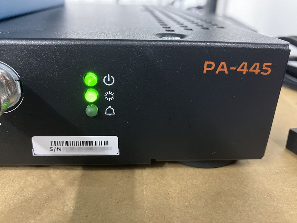

Dear Team,
I noticed something unusual during my testing.
PA-445 was configured as HA.
The front LED of typical firewall hardware is orange when in the passive state.
However, for the PA-445, both Active and Passive Devices are green.
As a result, active and passive cannot be distinguished visually.
The PAN-OS version in use is 11.1.4.
If anyone have any helpful information about this symptom, please let us know.
I'll attach my PA-445 front panel.
There is no LED for HA. From top to bottom, there are...
-Power
-Status
-Alarm
If it's normal status, LED should be GREEN, GREEN, and OFF even it's active state or passive state.
Note: Status(LED in the middle) might be yellow/red when fw is booting up.
-Power
-Status
-Alarm
@emr_1
Thank you for your reply!!
But according to the URL below, the LED of the Passive PA-445 should display yellow.
URL : https://docs.paloaltonetworks.com/hardware/pa-400-hardware-reference/service-the-pa-400-firewall-har...
Please note
I'm thinking document is wrong. As you can see, there is no LED for HA.
OR do you mean you have 4th LED on your PA-445 (differ from my PA-445?)
@emr_1
I completely understand... I think it's just an error in the document.
Your answer was very helpful.
