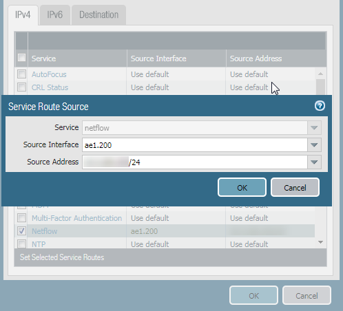

In our case we are exporting Netflow on one of our internal layer 3 routed interfaces.  We had to adjust the internal service route to accomidate this but it seems to work without issue.  We do of course have the extra burden of netflow traffic on that internal interface, but its not an issue in our case as we have a 20G trunk.

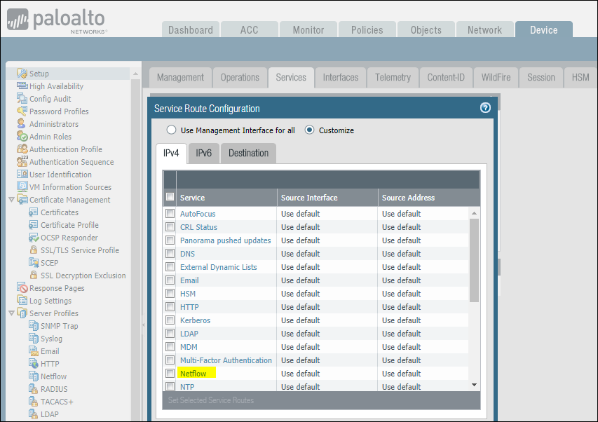

Why cannot you use the management interface for your netflow export? We are and it works as expected. Check your 'Service Routes' config and it should tell you which interface is being used.

The management interface is not supported for Netflow export (even though its in the list) on the new PAN-5220 hardware.  It has something to do with the way the traffic is processed by the dataplane in the new hardware that Netflow traffic is not sent to the management plane.  It took a case with Palo Alto to determine this and the fix (as its not or wasn't documented at the time).  On our new PAN-220 models, you can still export Netflow via the management interface like normal.  I'm not sure about the newer PAN-800 and PAN-32xx models.
On the plus side, because Netflow is now processed differently, you can get exports from subinterfaces now as well, which apparently wasn't supported before (and the support engineer kept insiting that it still wasn't supported even though I was showing him flows in LiveNX).
