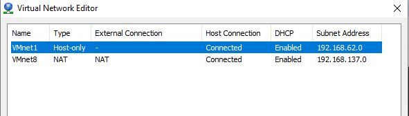

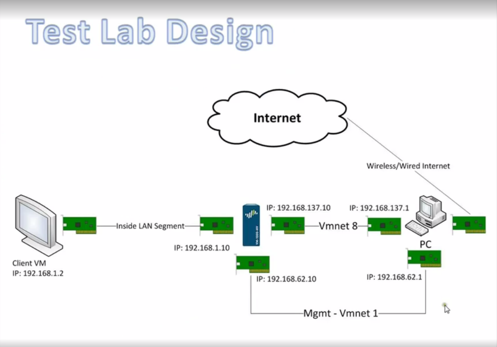

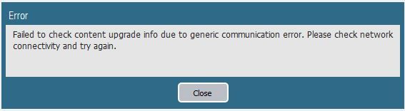

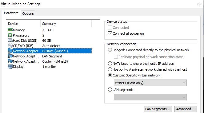

I have installed a Palo Alto firewall on my vmware workstation 8.0, with current settings i am able to access the Firewall GUI from my machine browser. But unfortunately, i am unable to connect to internet via firewall interface. I have 3 interfaces namely - mgmt, Untrust and Trust. I am trying to update license on firewall which requires internet access, but ending up a message.
"Failed to check content upgrade info due to generic communication error. Please check network connectivity and try again."
Here i am attaching the connectivity diagram, virtual network editor and network interfaces screenshot.

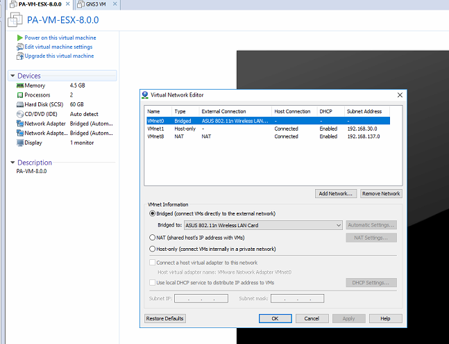

can you please "bridge" your first network adapter (mgmt) to your PC network card:
This will let you use your physical PC interface card in order to get to the Internet through your home router.
