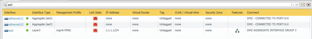

I need to configure an aggregate interface in the HA pair for their DMZ switch. We do not need sub-interface (Tagging) as it will be a direct connection. I did create the AE3, and then added the E1/1 and E1/2 to the AE group. I configured the AE3 as Layer 3 with an IP address as it will be the default gateway for the servers sitting in the DMZ. LACP is also enabled in the aggregate group.

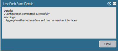

When I push the policy template from Panorama to the HA pair, Panorama returns the following warning: "Aggregate Ethernet AE3 has no member interfaces".

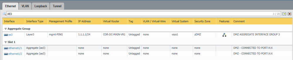

When I log in the Active firewall, and look at the interface list, I can see that the template was applied and the interfaces are associated to AE3.

Do you see the same warning also locally on the firewall for the commit-all job?
Did you (or another admin accidentially) push the configuration already when you haven't added the interfaces to the AE group, so that this warning is not from rhe newest commit-all?

Thanks for the hints. You are completely right. I was not seen the same error locally, but I did notice some disparaty between the template and the local configuration.
When I tried to push the configuration locally, it pointed some lose sub-interfaces in the VR that did not exist in the template and locally either.
I had to remove them from the VR, as well as from the zone configuration. Also, because the VR and the Zone had been overriden, I had to revert it to Panorama to apply the correct changes.
Because of the above issues, although in the template I had the zone and virtual-router assigned, this part of the configuration was not being pushed to the appliance.
