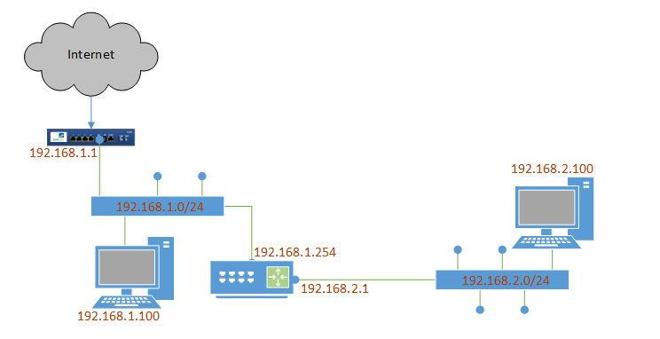

I have this scenario:
My PA-200 have 2 interfaces: one connected to the Internet Zone, another to the LAN Zone. The LAN interface has 192.168.1.1/24 as its IP address. I have another LAN connected through a router with 192.168.1.254 IP address.
In the PA-200, in the default-router I added the route for 192.168.2.0/24 with gateway 192.168.1.254.
Ping works, traceroute too. But when I try remote desktop, HTTP, telnet (or any TCP) from 192.168.1.100 to 192.168.2.100 (or vice versa), cannot connect and get "time out" message
Both 192.168.1.0/24 and 192.168.2.0/24 are in the same zone. What is the cause I cannot make TCP connections between this 2 LANs?
I am using PANOS 7.0.3
Best Regards to everyone.

Asymmetric routing. I think traffic syn is going through PA and syn-ack is coming directy to device and then ack is going to PA and PA is dropping it.
As a work around do a source NAT of the traffic to 1.1 for traffic coming from 1.100 goging to 2.100.

Yes but instead of that you can try the workaround suggested by me.
Hi
please try configuring U-Turn NAT: How to Configure U-Turn NAT
Apart from NAT, if possible, you can have static persistent routes on the hosts in 192.168.1.0/24 segment to route traffic for 192.168.2.0/24 via the router 192.168.1.254.
I am not sure of the purpose of the router but can you also move the router and the segment 192.168.2.0/24 as a new zone on PA-200.
Though technically possible, the firewall should not send traffic back from the same interface where it is received from.
