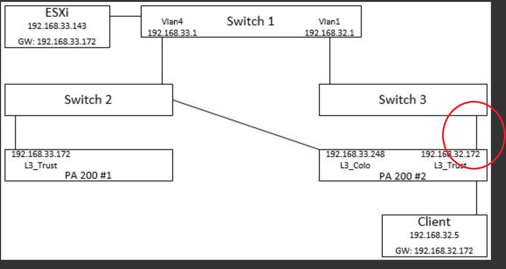

I am trying to reproduce a configuration from work where we use a Metro Line to connect our two sites.  It's working at my job, but not at home.  It seems like a simple setup and I think I am close, but having an issue.  Checking if anyone may have a comment?
My test is trying to connect to my esxi server from vsphere client, but unable to connect.  However, ping works everywhere.  Other traffic like web does not work either, just ping at the moment.
I've created static routes on the PA devices to handle traffic like it is at work.

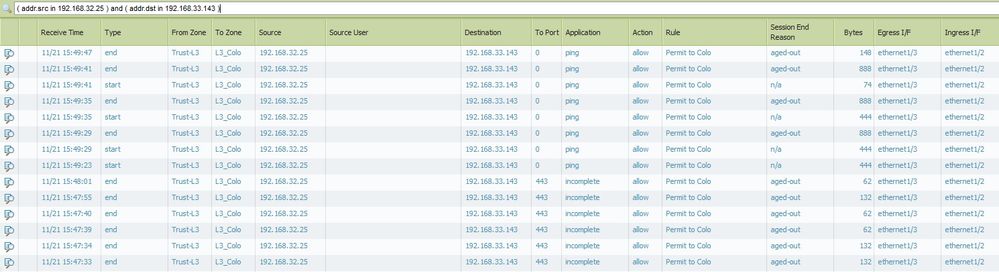

Part of my troubleshooting.  The traffic log on PA 200 #2 does register traffic to the appropriate security rule, but says incomplete.  The pings are successful.  This example was me trying to access the esxi server IP via browser.
Hi @OMatlock,
I wonder if you have asynchronus routing caused by the switch 1. Can you try running a packet capture on the interface circled to see if the return traffic is coming back to the wrong interface?  As I understand it you want the traffic to be coming back to ethernet1/3 on the PA-200 #2.
If this is the issue then I would think you can resolve it with a NAT rule.

Thank for responding bmorris1.
I did have ip routing enabled on switch 1, but have now disabled it.  Still same issue.

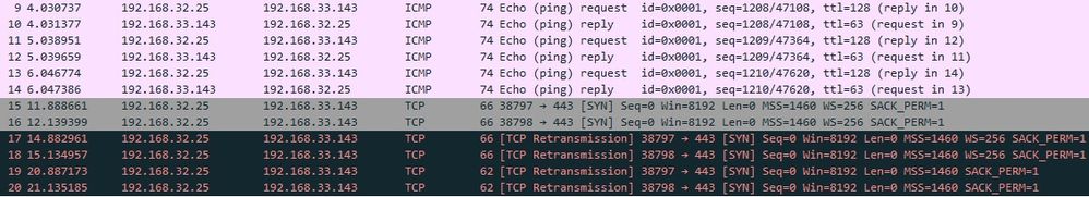

I ran a capture on PA 200 #2 using filters for these two specific ips and ingress interface 1/2.  You can see the pings are successful, but attempting to browse the web page of this server does not work.  Works fine when client is on the same subnet.

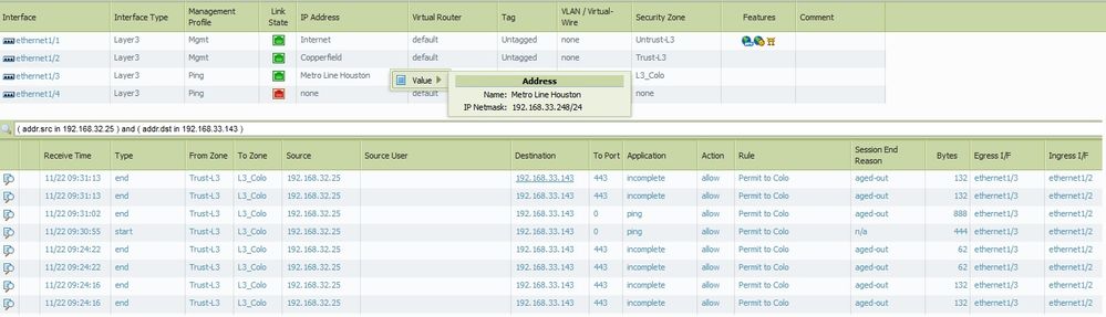

I was thinking that the ingress and egress indications from the traffic log are correct.  When pinging (or attempting to access) from 192.168.32.25 to 192.168.33.143, it seems correct for egress to be 1/3 and ingress to be 1/2.  Sound/look right?
