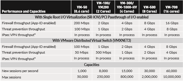

For those who runs the VM Firewall in your home test  lab enivronment,  can you share your choice of hypervisor, also your current detail hardware spec?    I am interested to setup a home lab ESXi server for testing PAN firewall and other projects as well.   But looking for hardware to support SR-IOV and DPDK seems to be very expensive.    If this is for lab testing or to use it to replace the home firewall (PA200), do I really need SR-IOV and DPDK?

SR-IO and DPDK  only increases througput,  no more no less
So it depends on your homelab requirements.
Do you want more than 600Mb Threat prevention throughput, you need SR-IO and DPDK  and a  vm100 or higher license

For PA200 performance with a VM-50 you don't need SR-IO and PCI passthrough
Speeds below are only valid for PAN-OS 8
