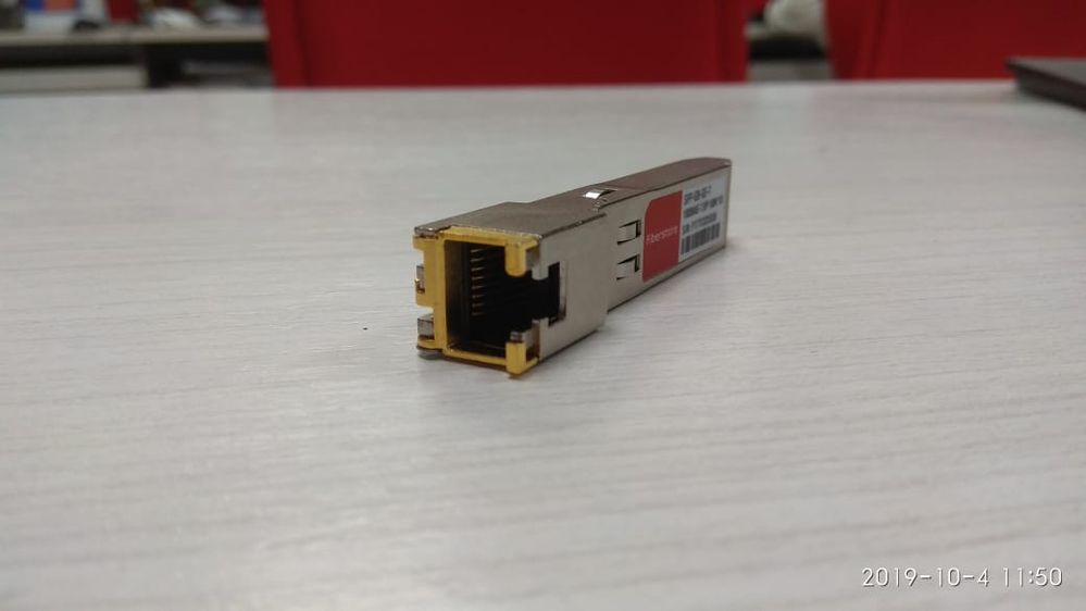

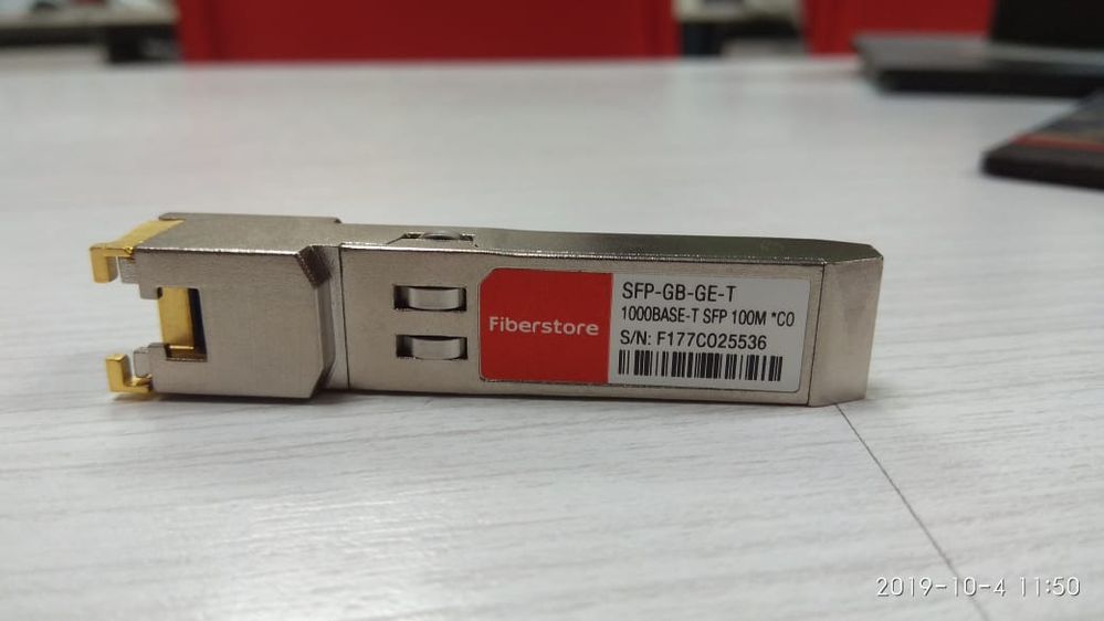

I am using below SFP modules with PA-820, These are Gigabit Ethernet interface and working fine for me.
> show system state filter sys.s1.p5.phy
sys.s1.p5.phy: { 'link-partner': { }, 'media': SFP-CAT5, 'sfp': { 'connector': Unknown, 'encoding': 8B10B, 'identifier': SFP, 'transceiver': 1000B-T, 'vendor-name': FiberStore , 'vendor-part-number': SFP-GB-GE-T , 'vendor-part-rev': B , }, 'type': Ethernet, }
