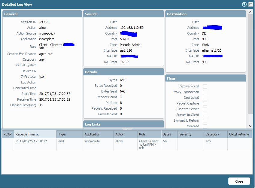

detailed log view:
Bytes send: 640
Bytes received: 0
Repeat Count: 1
Packets: 8
Looks like you stealing an information:) Just post snip of your detailed session and NAT rule for the client (wipe sensitive info from logs).  What version of PAN-OS you running?

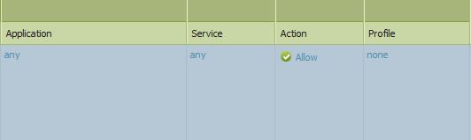

Security Rule:
NAT Rule is just a dynamic-ip-and-port Source Translation.

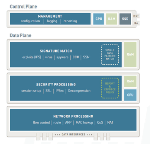

PS: What effect does "Restart Dataplane" under Device -> Operations have?
When do I use it?
Good point actually. As it was a silent drop (no RST or reject received by PA). Dataplane @reaper should have an answer. l never use that option
The dataplane is what actually processes all of your traffic. Restarting it would essentially temporarly stop traffic from being processed while the dataplane comes back up. You really only use it if you suspect that one of the processes isn't functioning correctly and need to restart it without actually restarting the box. It's quite a bit faster than restarting the whole thing as you only have to wait for 'half' the box to come back up. This graph might help.
@BPry Pretty good explanation l would say. I did play with management plane process restart where the issues seen more often
@TranceforLife I would say that the majority of issues that people run into can be attributed to a management process and not a dataplane process. Really since restarting the dataplane is going to have an impact anyways most of the time if we do run into an issue that could be fixed with a dataplane restart we just restart the whole thing.
