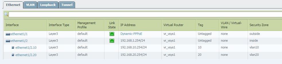

we work on our organisation to do the migration of the configuration from another firewall to the palo lato networks PA-500 . With the recent architecture the segmentation of the networks is in the switch . But now , we like to do this segmentation in the PA-500 by creation of subinterfaces . we like to do like show the screenshot : a router of trafic from inside to outside that a second router from vlan 10 to inside than another router from vlan 20 to inside . The interface eth1/2 is related with a truk port configured on the switch with tagged vlan 10 and vlan 20.
The problem that the traffic not passe to the subinterfaces! Please correct me if there is any mistake that i make it in my configuration.
You're proably missing VLAN 1 on trunk between switch and PA.
Besides you're speaking of different (virtual) routers and you have only 1 for all interfaces (vr_vsys1). But that shouldn't be a problem, in fact that should make your life easier.
Hard to tell much more without seeing all configuration and rules.
Do you also have the security policies setup betwee zones vlan10 to inside; vlan20 to inside; and inside to outside.
You will also need a NAT policy for inside to outside.

I notice you are using default management profile on all interfaces. Normaly I would use profile that allows ping only on such interfaces.
Can you ping PA interfaces from switch or laptop connected to one of the switch ports?
If answer is positive to all this, then you will need to have permissive security policy that allows traffic to flow between the zones.

Thank you very much for all the respenses. It's ok , the configuration now work in Layer 3 by adding a Nat rules in the Palo Alto Networks from a vlan to outside.
