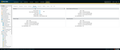

We have a client who all of a sudden started to receive the following telemetry error -  'CDL Receiver Key Empty' on PA-440. No changes have been made. Currently running PAN OS 10.1.2. They are not using CDL and are just sending Telemetry data to PA with a certificate. This looks like it may be a an issue on the PA backend.

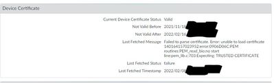

Firewall did not receive the signed URL key required back from PAN servers to upload telemetry data (based on the telemetry logs), which looks to have caused the error. Also, the firewall failed to fetch the device certificate correctly upon 3 month renewal. Rebooted firewall and waited 24 hours and the firewall was then able to retrieve the certificate and telemetry data began to flow successfully again.
Looked to have been an issue with the Palo Alto back end as no changes were made on the firewall except a reboot, but am not quite sure.

I have this same issue on 10.1.6-H6 and thus far a reboot has not fixed it.  Shows my device cert is good and CDL is showing current logs.  But AIOps stopped getting telemetry data about a week ago.
I also see

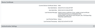

My PA-3430 devices running 10.2.3-h2 had this issue.  Device certificate was a week away from expiring but still causing the CDL error apparently.
request certificate fetch
Fixed the issue.

This is now listed as a known issue in the release notes of 10.2.4.
PAN-208325
The following NextGen firewalls and Panorama management server models are unable to automatically renew the device certificate (
Device
Setup
Management
or
Panorama
Setup
Management
  • M-300 and M-700
  • PA-410 Firewall
  • PA-440, PA-450, and PA-460 Firewalls
  • PA-3400 Series
  • PA-5410, PA-5420, and PA-5430 Firewalls
  • PA-5450 Firewall
Workaround:
Log in to the firewall CLI or Panorama CLI and fetch the device certificate.
admin>
