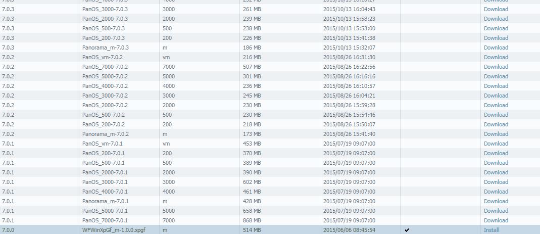

I have some questions regarding the upgrade of Panorama and firewalls to version 7.0.3. I am looking to upgrade both fairly soon, and want to avoid any gotchas. My environment currently has Panorama at 6.1.4 and all firewalls at 6.1.4 or 6.1.2. I am aware of the need to upgrade to major versions prior to minor versions (for example, 7.0 before 7.0.3). The first question I have is regarding Panorama. I just did a Check Now for my Panorama software, and a base 7.0 did not show up, only 7.0.1, 7.0.2, and 7.0.3. Does Panorama not adhere to the 7.0 base first rule?
With regard to the firewalls, I see what looks like a base 7.0 under Device Deployment>Software in my Panorama console. However, it seems to be named different (See screenshot below) and has an "m" designation. Based on what I read, I would be downloading and installing this, then downloading and installing the 7.0.3 version for my firewall model, correct? Also, how long can I wait between upgrading Panorama and the firewalls. I had thought to upgrade Panorama and wait a few days before doing the firewalls, but now I see mention of an LDAP issue when doing a commit through Panorama when it is 7.x and the firewalls are 6.x. These are the gotcha type issues I am hoping to avoid.

Hi Scott,
PAN OS 7.0.0 was pulled off due to a major vulnerability. So, it is no more available for downloads and the base image has been replaced by 7.0.1. So, you will need to download 7.0.1 to upgrade to higher major versions.

Thank you for the information @singh I appreciate it. Can you verify whether upgrading Panorama requires the base version first routine? In the instructions I found, it is not clear whether this is appropriate for Panorama, or just the firewall.

Okay, I am just going to take Panorama right to version 7.0.3 straight away.From what I have read, it seems Panorama can be taken directly to where it needs to be.
For the actual firewalls, I will follow the directions regarding the base version and then the maintenance version.

Base image is required for both Panorama and firewall.
