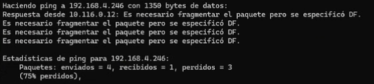

- Given this error, I checked the GlobalProtect source IP logs and everything appeared to be allowed.
Then, I tried pinging from an affected endpoint with a custom length and the DF "Don't Fragment" bit active set to 1350 bytes, and the ping was dropped by fragmentation needed. as shown below:

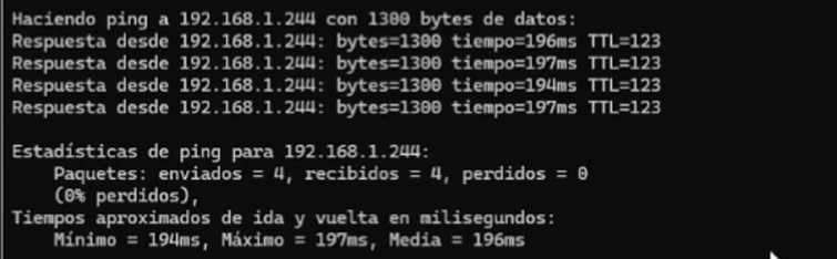

Then I try it with 1300 Bytes as the payload and the ping works!

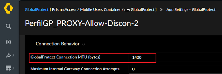

So, as a test, I changed the Prisma Access GlobalProtect tunnel MTU to 1300 bytes (default is 1400 bytes) and the gpupdate /force command works!
PRISMA ACCESS GLOBAL PROTECT CONNECTION MTU ADJUSTMENT FROM 1400 TO 1300 BYTES

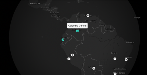

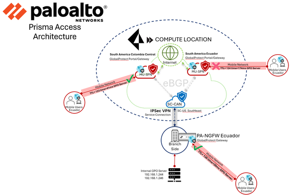

15- The backend team deploys and upgraded a new gateway node in the Central Colombia region., then we setup the tunnel for the Colombia location and also tested with user connected to the GPGW Colombia location and saw significant improvement with GPO's finishing between 6-8 minutes sucessfully, as belows:

- Prisma Access offers worldwide locations for deployment, and a key best practice is to choose locations that are geographically closest to your users or NGFWs to connect with SC-CANs or RN-SPN nodes.
- Deploying a gateway node in a region like Colombia Central directly addresses potential latency and performance issues by reducing the physical distance data needs to travel between the user and the Prisma Access service.
- This successful deployment demonstrates a well-executed troubleshooting step that directly aligns with Prisma Access best practices for optimizing mobile user connectivity and performance.

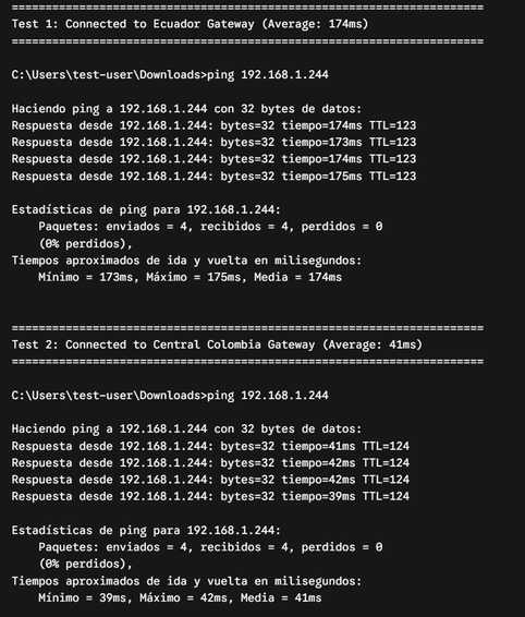

- SMB is a chattier protocol that performs poorly under elevated latency. The previous route via the MU-SPN South America Ecuador gateway incurred round-trip times of ~174 ms, causing severe GPO processing delays and timeouts.
- Modifying client/firewall configurations (MTU adjustments, DSRI, IPv6 disabling, App-ID overrides, QoS, App Acceleration, and gateway CPU upgrades) did not mitigate the issue because the underlying constraint was physical propagation delay across regions.
Why Colombia Central Solved the Issue?
- BGP Routing & Latency (~174 ms in Ecuador): Traffic targeting Colombia-bound resources via the Ecuador gateway suffered from regional BGP routing paths. In South-America ISPs, cross-border traffic frequently hairpins through international NAPs (such as Miami) rather than taking direct terrestrial routes. This added massive physical propagation delay, raising RTT to ~174 ms.
- SMB/GPO Protocol Sensitivity: Group Policy Object updates rely heavily on SMB/CIFS (TCP 445). SMB is an inherently "chatty" protocol that requires hundreds of sequential round-trips to negotiate sessions and transfer data. At ~174 ms, this back-and-forth communication accumulated into severe application timeouts and failed GPO syncs.
- Direct Local Peering (~41 ms in Central Colombia): Moving to the Central Colombia gateway kept the traffic within national ISP peering networks, bypassing international hops. Dropping the latency to ~41 ms reduced SMB transaction overhead to normal operational levels, allowing GPOs to complete successfully within 6–8 minutes.
