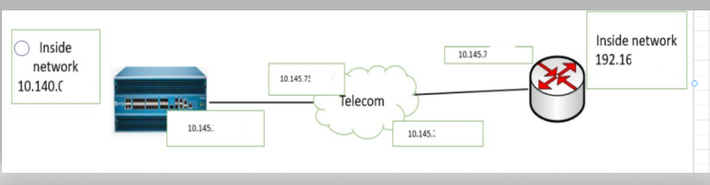

 I am going to configure  Palo alto 5250 firewall to   branch   Huawei router
The device is not physically connected ,  i try to  do static route from Palo alto to  Huawei router router but the network is not reachable.
kindly support me how to fix   type of issues ,
Help me also kindly  suggest me new solution for this type of network scenario
Hi there,
You have one of two options, either source-NAT the traffic leaving the PA and Hauwei have a corresponding static-NAT at the destination and have it travel 'in the clear' across the telecom network. Or, create a Layer3 IPSec tunnel between the PA and Huawei and route directly between them.
Using the tunnel would be the preferred option as it will protect your traffic flows from snooping and interception. It will also allow you to configure a dynamic routing protocol between the two sites to share prefixes.
This option is the most scalable as the dynamic routing will handle increases in target IPs and not require additional static-NAT configuration.
Whichever solution you choose, you will need to configure a security policy on both the PA and Huawei to let the traffic flows into the sites.
cheers,
Seb.
What type of interface  used to do source-NAT in the PA side ,   sub interface  ?    also in Huawei router side  ?  since  not physical connection
Hi there,
By its design source-NAT must be configured on a layer3 interface: physical, physical sub-interface, VLAN.
cheers,
Seb.

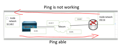

Dear Friend
Still not solved , ping from firewall to remote router is working but ping from remote router to firewall is not still working. Also i cant ping 8.8.8.8 from Palo alto maybe if the issue is linked with. I can't ping  a Firewall interface side
Could you please check if the management profile is correctly applied on the interface you are trying to ping?
https://docs.paloaltonetworks.com/pan-os/10-1/pan-os-networking-admin/configure-interfaces/use-inter...
