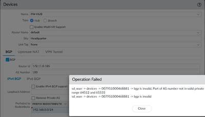

I'm encountering a similar scenario.
In an environment with BGP configured (Public AS), is there any way to use this Public AS in the automation of the SD-WAN plugin within the BGP settings?

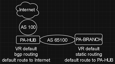

I have the following topology:
When I try to insert the BGP configurations for automated tunnel creation, I receive a failure notification when inputting this information:
According to the documentation, it should be possible to use BGP in this context, but it doesn’t specify if there are any issues related to using a Public vs. Private AS.

Update:
The firewall's direct documentation states that Palo Alto's SD-WAN only supports private BGP. 😞
https://docs.paloaltonetworks.com/plugins/sd-wan/2-1/panorama-sd-wan-plugin-help/panorama-sd-wan-plu...
However, in my humble opinion, using multi-VR doesn’t solve the scenario, as it’s not possible to add the same device in the SD-WAN automation while needing to use both VRs.
