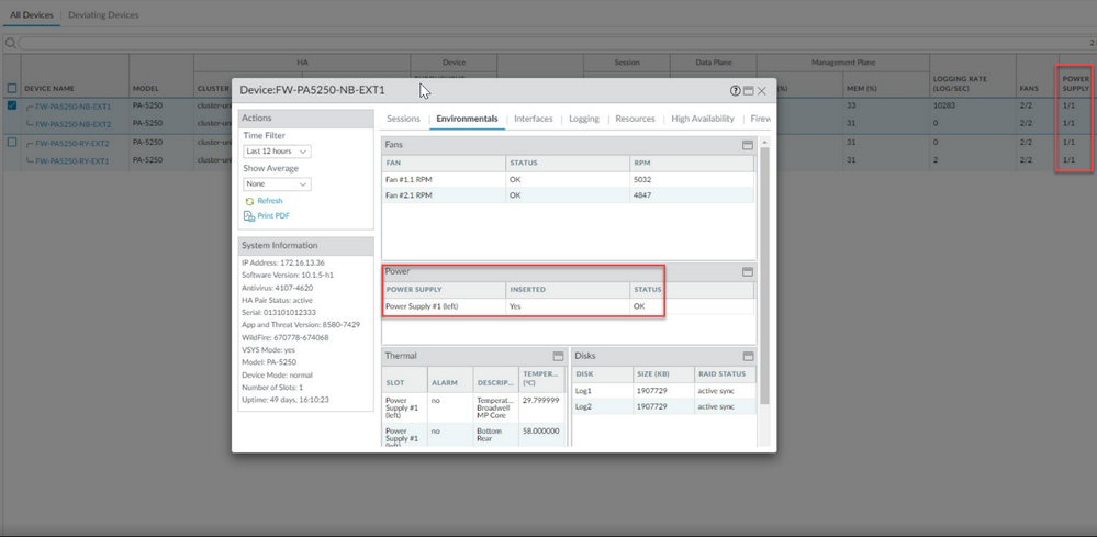

We found an issue about monitoring managed device power supply.
We managed PA5250 that have 2 power supply but we see only 1 power supply(left).
PANOS -10.1.5-h1 and 10.1.6 found the same issue
We want to know if this is normal or not?
I have the same issue. Currently on 10.1.6-h6. Did you find a resolution?
Hello @Sawittree @Curtess_Samuels
this defect seem to be resolved in PAN-OS 10.1.11 released this week:
PAN-179888
Fixed an issue on Panorama where the number of managed firewalls Power Supplies did not display a correct count.
